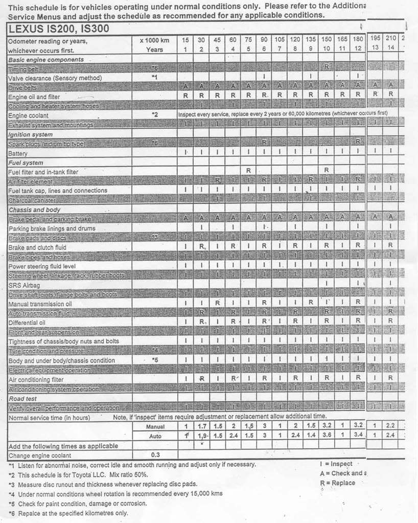

IS200/IS300 Maintenance Scheduled time
Post by banan1984 »
Nie znalazlem na forum wiec zalaczam plik.
(150.85 KiB) Downloaded 779 times
