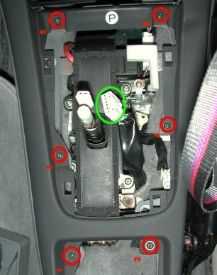

Firstly, put the gear selector into 'N'. This will require you to press the small red button next to the gear selector so that you can move the gear out of park with the ignition off. Now you know what the red button's for! Don't forget to make sure the handbrake's on. Then slide down the plastic sleeve at the bottom of the gear stick, and undo the two screws, it should then pull straight off.
1
2
3

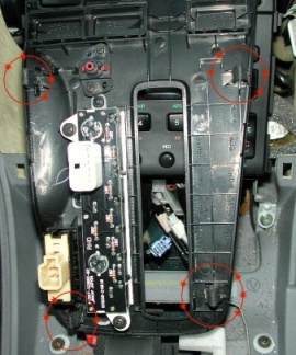

Then you need to remove the black plastic gear selector panel, to do this you need to unclip 4 clips, in each corner of this panel. This can be fiddly first time round, but once you've done it you'll be popping it in and out no worries. Retain the felt pads around the clips and be sure to replace them properly afterwards for a rattle-free future.
4
